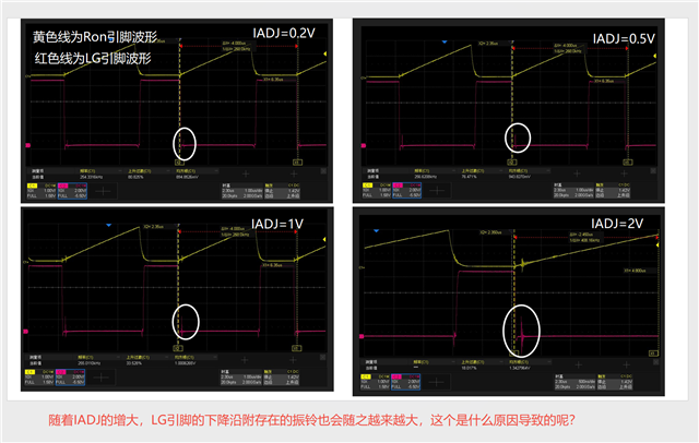

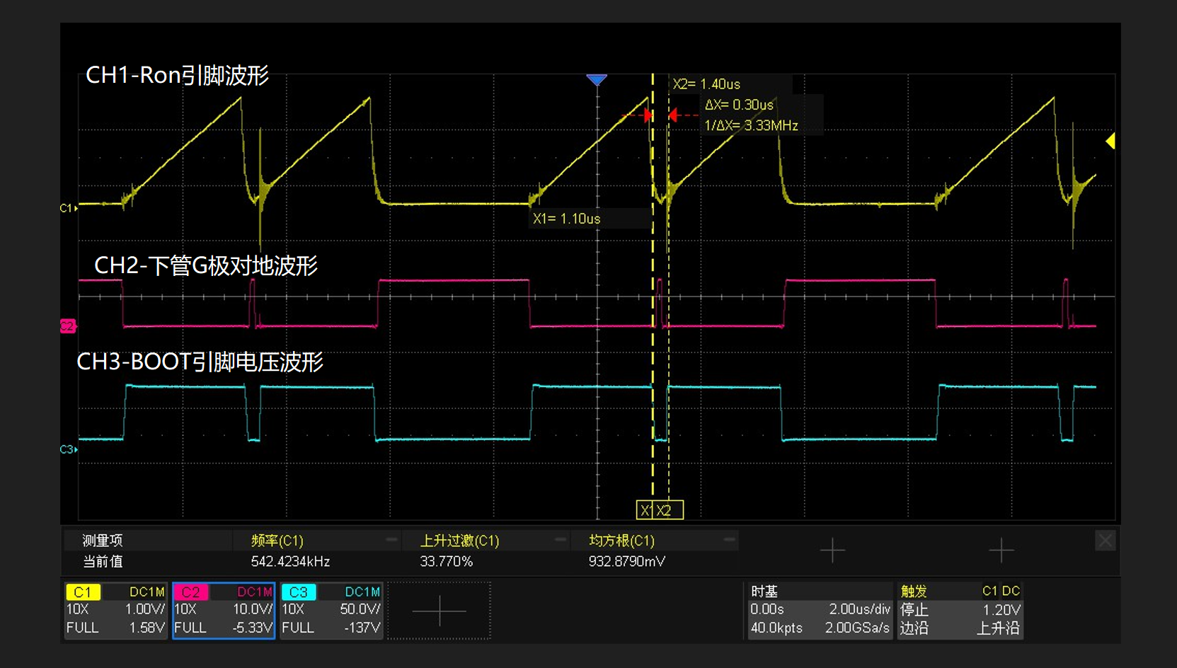

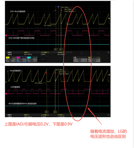

测试波形如下图所示

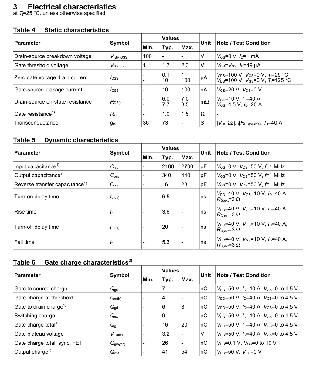

MOS管型号为BSC070N10LS5ATMA1,其部分参数如下
输入48V,设计输出36V/16A,开关频率设计为250KHz,上述波形是在IADJ引脚给的输入0.2V,SDIM引脚给的3.3V,条件下测试得到
上述LG引脚波形异常的原因是什么,以及波形频率和预期设计值偏差较大是什么原因导致的

附件为原理图,其中芯片Vcc引脚缺少对地的电容,实际调试过程中通过跳线焊接将其补上
您好
G引脚驱动低边MOS管的路径上串联一个1Ω的电阻,是否需要增加该电阻的值?
In synchronous rectifier, the high speed gate drive signals can generate significant conducted and radiated EMI. This noise can couple with high impedance nodes of the IC and result in undesirable operation. A small (4 Ω to 10 Ω) resistors, RHG and RLG, in series with the gate drive signals are recommended to slow the slew-rate of the SW node and reduce the noise signature. They also improve the robustness of the circuit by reducing the noise coupling in to sensitive nodes such as UDIM, CS, RON and IADJ.
请您从参考datasheet这部说明做只当调整。
