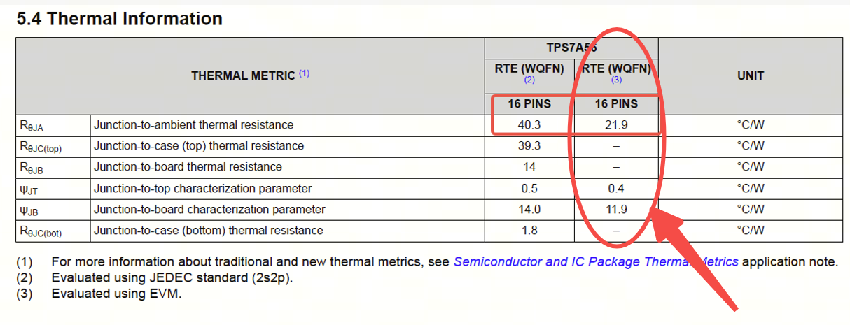

As shown in the figure, there is a significant difference in the thermal resistance parameters for the TPS7A56 between the EVM-based values ​​and those based on the JEDEC standard. Please provide all the thermal resistance coefficients corresponding to the EVM, as we need them for the thermal simulation of the device on our application board.
