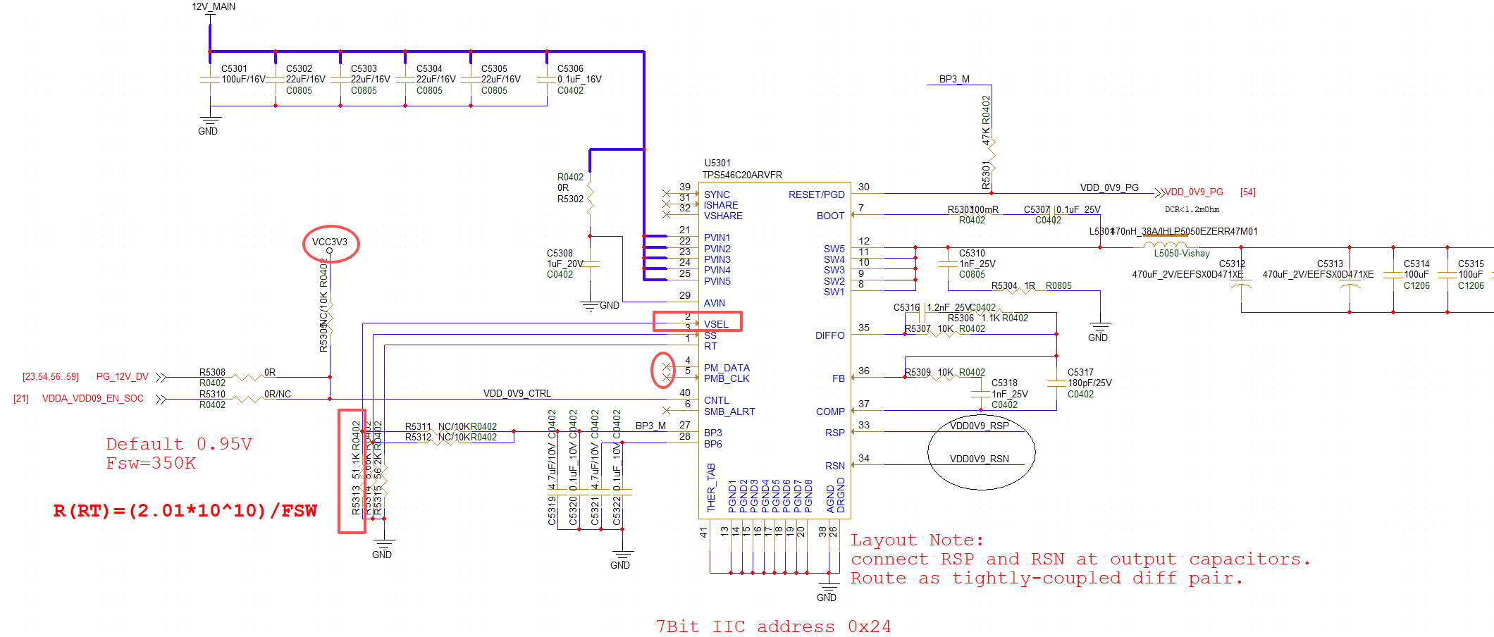

planning to use the TPS546C20A power supply, output of 0.9V and 10A. don't use the PMB-DATA and PMB-CLK pins . onlyu use CNTL pull-up and configure VSEL pull-down resistors. Can I achieve outputs of 0.9V and 10A?
