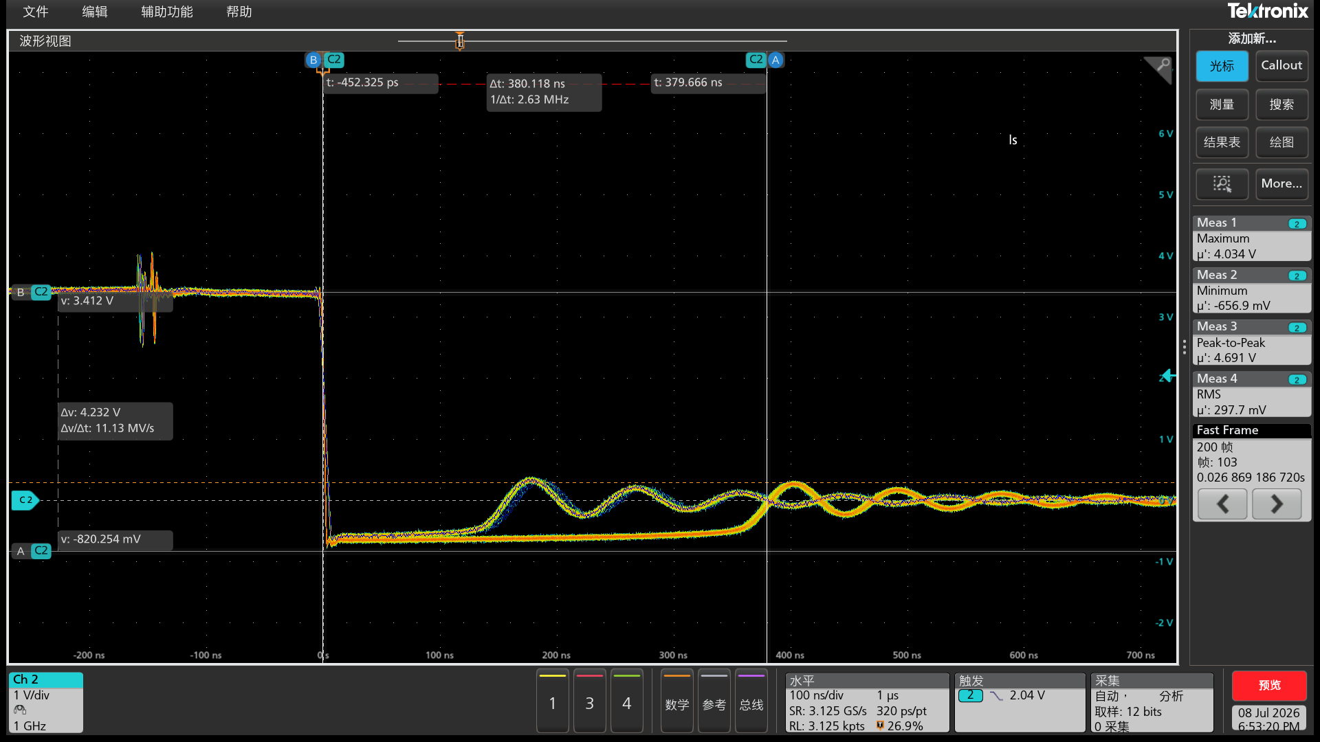

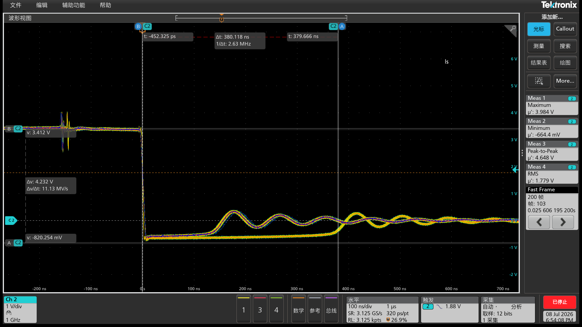

TPS63805使用在5V转3V3的应用中时,测量到L1、L2两端的最低电压为负压,虽然负压的电压在芯片的耐受-3V以内,但负压持续时间可以达到200~300ns,请问这样的情况下会导致芯片损坏吗,还是说是正常的现象
参考Lei在下方链接中的回复。
TPS63805: Analysis of the SW2 pin overshoot on the TPS63805 - Power management forum - Power management - TI E2E support forums
Hello, above is the superimposed waveform of 200 test samples at the falling edge of SW2. As shown, there is a prolonged negative voltage. The PCB design follows the recommended guidelines.
