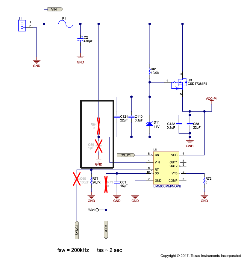

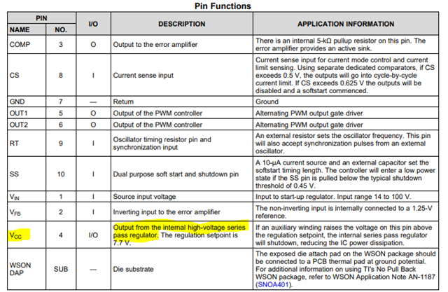

For components marked with crosses on the schematic: does this indicate the circuit is open when the component is unpopulated, or that we may short its pads directly?If the component is not mounted, leaving the LM5030 VIN pin without supply voltage, will the IC not start?Thank you very much for your explanation.
