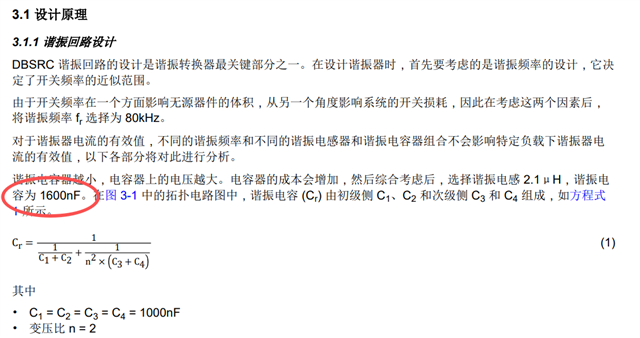

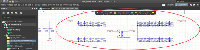

In the design guide of tida-010966, it is mentioned that the value of the resonant capacitor is 1.6uf, but in the corresponding schematic, the calculated result is not 1.6uf, which is different from the design guide.
Another question is, what is the source of the resonant inductance in tida-010966, and is it an additional external inductance? Or should we use the leakage inductance of the transformer as the resonant inductance?
