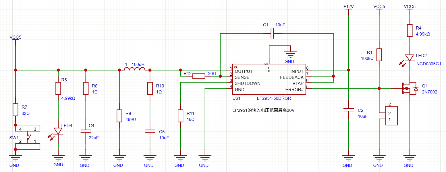

Now I use LP2951-50DRGR to provide a fixed output of 5V in my system. I found a description in the datasheet that ERROR will go low when Vout drops 6% of its norminal value. I calculate that 5V * 94% equals to 4.7V. It means that when the Vout is below 4.7V, then ERROR PIN will go low. Now I connect a resistor of 33ohm between Vout and GND, then I found that the Vout = 4.4V, but the ERROR does NOT go low, still provide 4.98V. So I will find your help.
I attached the schematic, using png form in the attachment, the circuit works like that, let me explain as below:
when I provide 12V as input, then LP2951 is powered. It will output 5V in the OUTPUT PIN. Now LED4 and LED2 should be lighted. When I press the buttow, a 33-ohm resistor is connected. Now the current is over 100mA. So the Vout should drop. And I measured the output voltage, the value is 4.4V, but ERROR PIN is still as high as 4.98V.
Thanks and looking forward to your reply.

  • Hi Joey,
    Could you please removeR12 and R11, and short them directly and remove C1 to let the connection open? And then have the same test.
    B.R.
    Eric
  • Hi Eric
    I have made a mistake and now I have already got the correct result.
    The L1 has a voltage drop, so when I measured VCC5, I have got the value of 4.4V, but LP2951 still provided 5V output at the OUTPUT PIN.
    Then I increased the output current  until the OUTPUT PIN had only 4.4V, then ERROR PIN had a low output.
    Finally I use one magnetic beads (ferrite) to instead of L1, and get the threshold value, it is 4.7v, below this value, ERROR has a low output, while above this value, ERROR has a high output.
    So R11, R12 and C1 does not have any impact on this circuit.
    Thanks for your reply.
