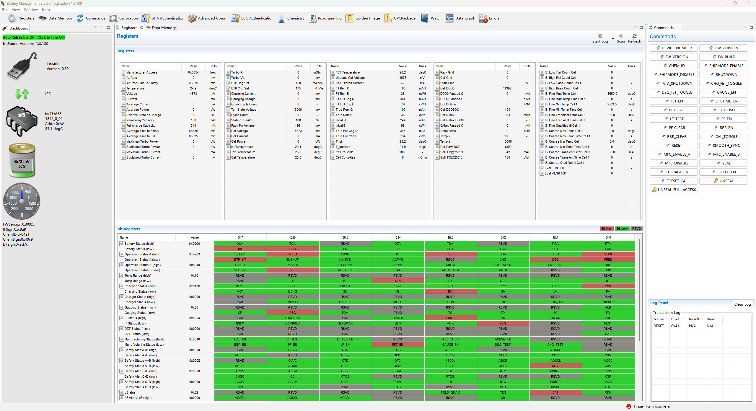

  1. Supply cell voltage to 3800mV,the EVM is working normal, both CHG and DSG=1, also Pack voltage = 3800mVf73712da47a4ceed5c75bec5e6f6e391.png

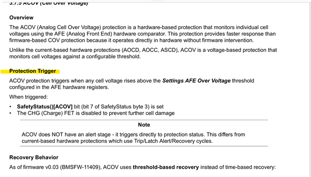

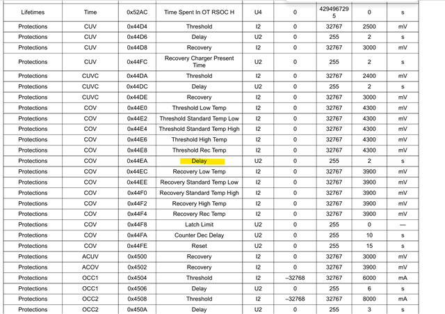

  2. Set Cell Voltage = 4575mV to trig ACOV, CHG=0, DSG=1, Pack Voltage is about 4200mV, less a CFET diode drop than Cell Voltage. But it shows COV, I think it should be ACOV? 95d62c224a037de5066571e20b72b38f.png

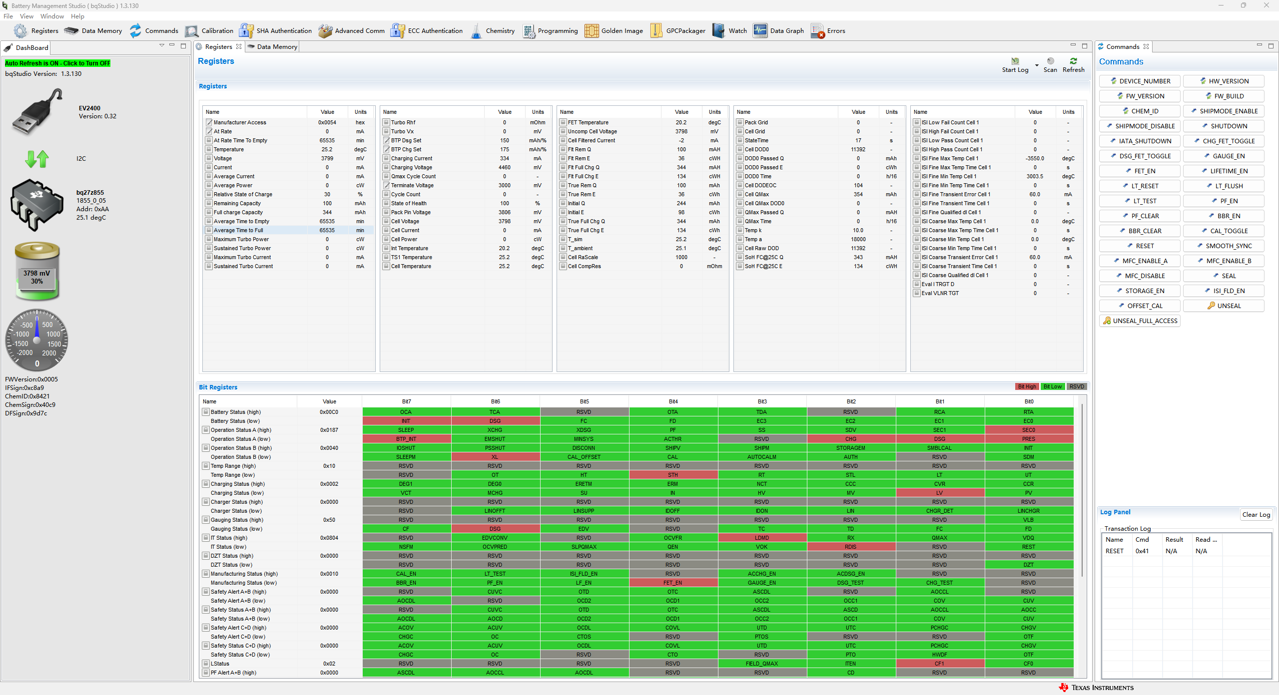

  3. Set Cell Voltage to 3800mV,  XCHG and COV=0, but CHG still = 0, Pack voltage less than Cell a diode drop means CFET is OFF. Why it can not released when Cell set back to normal? c9838131df6fc4848c9084bf5c0819ac.pngThank you for your attention to this issue
