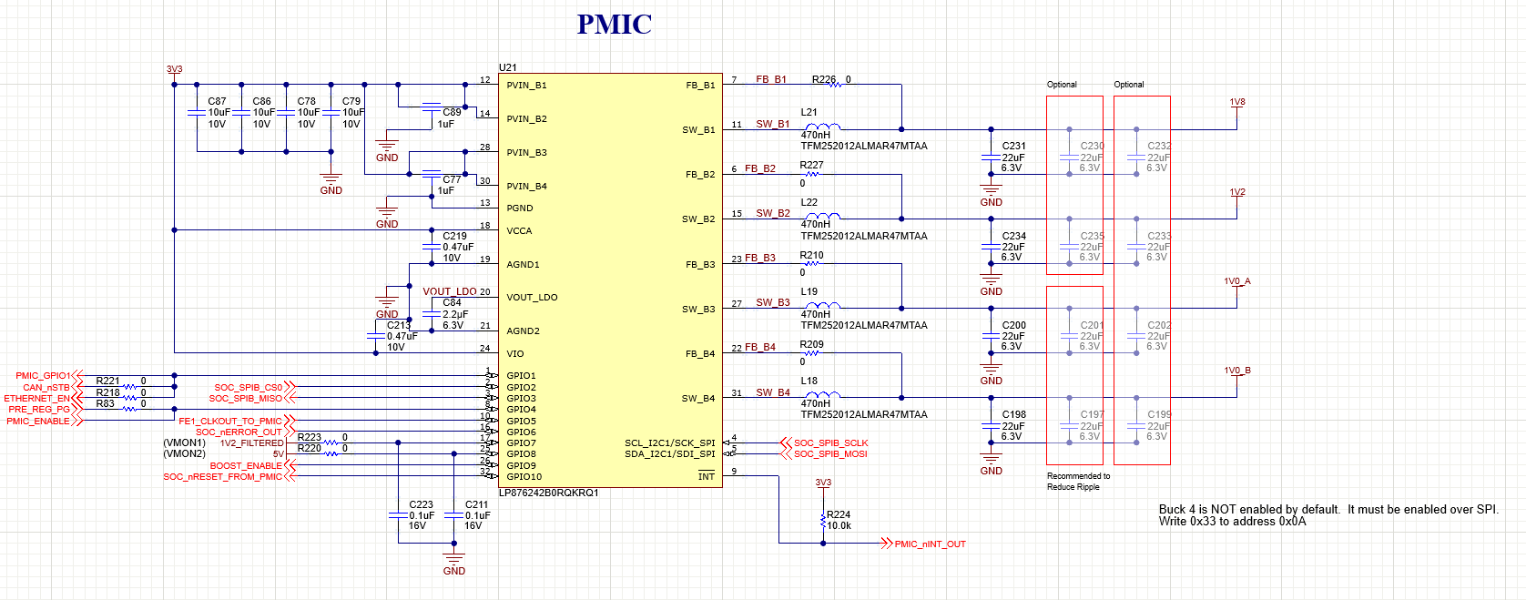

I made the circuit board based on the TIDA-020047 specification on the TI website. Now I have discovered some issues and I am seeking help to solve them. The LP876242B0RQKRQ1 is not outputting 1.8V, 1.2V, 1.0V, etc. normally. I followed the method of others on the forum to externally input 1.2V to GPIO7, but only SW_B2 has a 1.2V output, while the others are all 0V.c0fc9da112792f3d45fbec4a6a1c4572.png

  • ninhao
     LP876242-Q1: LP876242无输出电压
    请您参考这个帖子的说明。
    Unless mentioned otherwise in the User's Guide for the orderable part number, the residual voltage
    monitoring is enabled .once, immediately after a power-up event on the VCCA input supply pin.
    Before the LP876242-Q1 executes the start-up sequence of the BUCK regulators, the LP876242-Q1
    disables all residual voltage monitors. TI has made this implementation to prevent false-positive
    residual-voltage detection caused by charge accumulation in the output capacitors of the BUCK
    regulators or at the output voltage rails monitored through VMON_1 (at GPIO7 pin) or VMON_2 (at
    GPIO8 pin).
