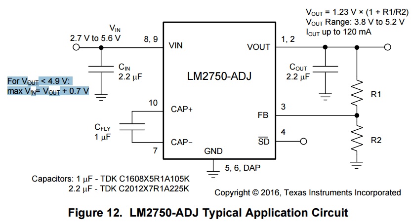

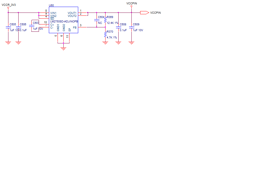

我现在打算使用LM2750SD-ADJ/NOPB输出4.5V电压,最大负载电流做30mA的样子,输入电压范围是3.1~3.6V,我看到LM3750 EVB KIT上有这段“Connect the input and ground pins of the evaluation board to a power supply or battery with short, lowimpedance, low-inductance wires or cables. The nominal input voltage range of the LM2750-ADJ is 2.7V to 5.6V, but at lower output voltages (Vout < 4.9V) the input voltage should never be more than 0.7V below the output voltage.“
所以这种情况下LM2750不能工作?
