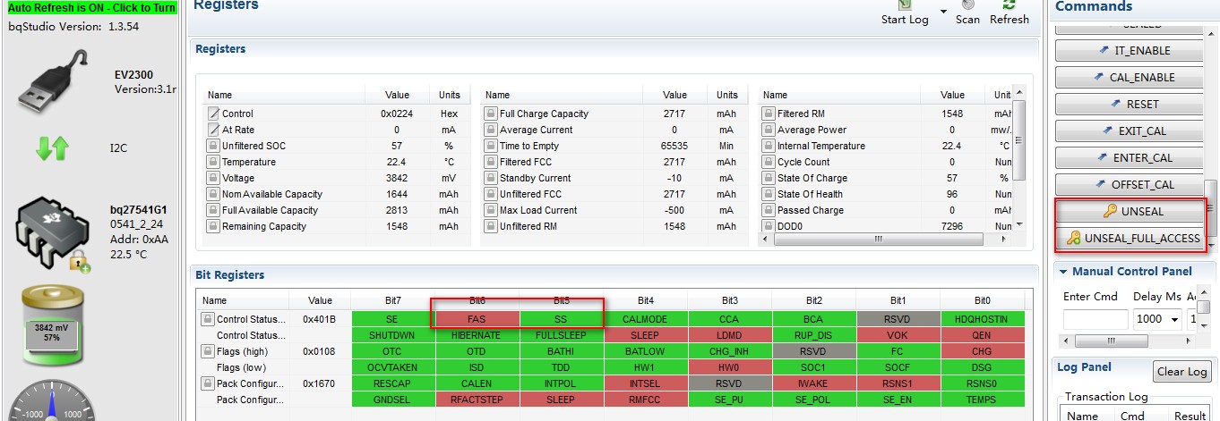

bq27541G1解密后如何进入Full Acess模式
您好,
     1,请问下bq27541G1解密后如何进入Full Acess模式,目前Seal to Unsealed和Unseal to Full的密码都一样,可以用命令解密但就是进解不了FAS,另外在界面上点击UNSEAL和UNSEAL_FULL_ACESS效果也是一样,只能进入Unseal?
  • "I think you will need to replace the device.  Do not change the access key to all zeros and do not change the full access key to be the same as the unseal key or you will never be able to get to full access mode."
    不能设成一样的
