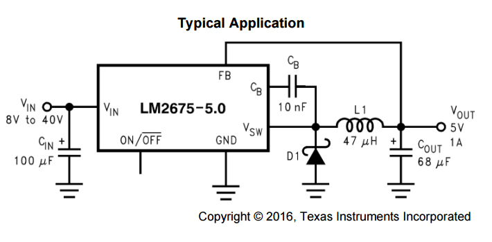

LM2675M的原理图如下:
ON/OFF引脚的说明是:
Enable input to the voltage regulator. High = ON and low = OFF. Pull this pin high or float to enable the regulator.
我理解是:
如果此引脚浮空,什么也不接,那么LM2675M是上电就会正常输出的对吗?
如果此引脚接地,那么芯片输出是0V吗?
