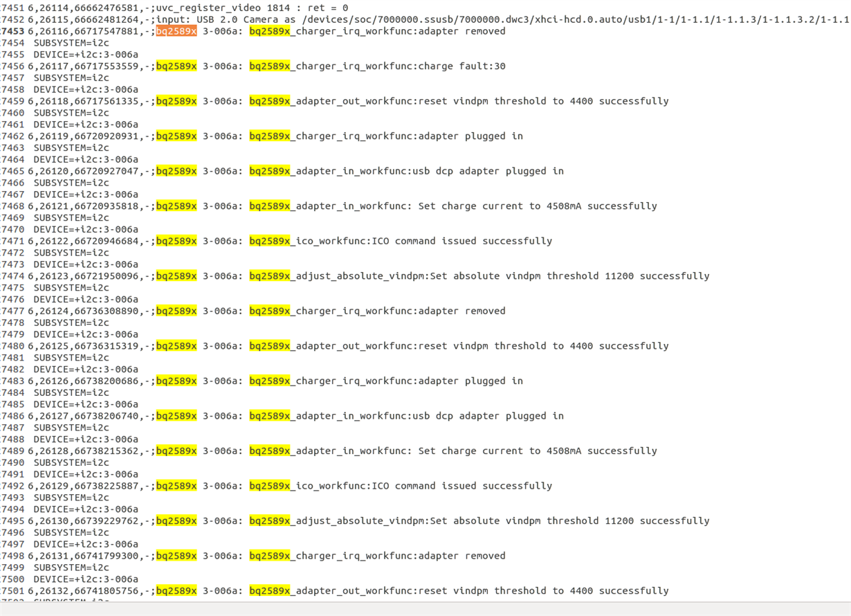

bq2589x watchdog timer 充电出错问题
HI,
充电的时候,发现充电指示灯在闪。把寄存器导出来看下。

把日志导出来。
bq2589x 3-006a: bq2589x_charger_irq_workfunc:adapter plugged in
bq2589x 3-006a: bq2589x_charger_irq_workfunc:charge fault:80       //REG80 value = 0x80, 1- Watchdog timer expiration,  怎么一开始就出现看门狗定时器过期?
bq2589x 3-006a: bq2589x_adapter_in_workfunc:usb dcp adapter plugged in
bq2589x 3-006a: bq2589x_adapter_in_workfunc: Set charge current to 4508mA successfully
bq2589x 3-006a: bq2589x_ico_workfunc:ICO command issued successfully
bq2589x 3-006a: bq2589x_adjust_absolute_vindpm:Set absolute vindpm threshold 11200 successfully
bq2589x 3-006a: bq2589x_charger_irq_workfunc:charge fault:30
后面又又一次拔插动作,下面的log。
