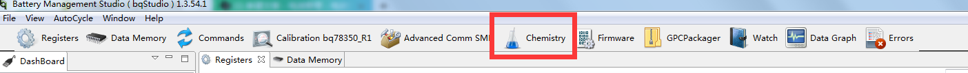

78350 通常配合bq769x0,用的是CEDV算法,但是有写入化学ID的功能,在什么情况下使用?
Other Parts Discussed in Thread: BQSTUDIO, BQ78350
  • 使用CEDV算法的电量计产品,不需要更改chemID, chemID是bqstudio为阻抗跟踪算法的电量计预存的功能。
  • The bq78350 uses the chemistry of the cells to estimate the state of charge of the pack after a reset.
    Chemistry information is not loaded to the device as a Data Memory parameter but by using the Chemistry
    view. Loading the chemistry is not required for simple operation of the EVM but will be desired for setup of
    the board or a part for operation with cells, particularly if the chemistry differs from the default.
