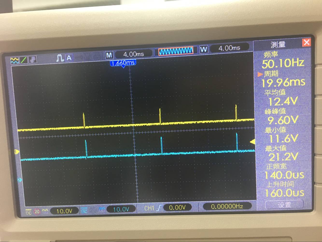

BQ762000PWR 同时高电平CP_EN,CHG_EN,DSG_EN 出现如下波形,单个打开DSG或CHG 工作正常
Genius 3755 points
  • 数据手册7.3.1 Charge Pump Control有说明,在下面这种情况下两个MOS是不会打开的,您参考一下:
    the C(VDDCP) is not scaled properly to support the number of FETs in parallel, the heavy loading would prevent the charge pump to ramp up above UVLO. CHG and DSG would not be turned on in this case.
