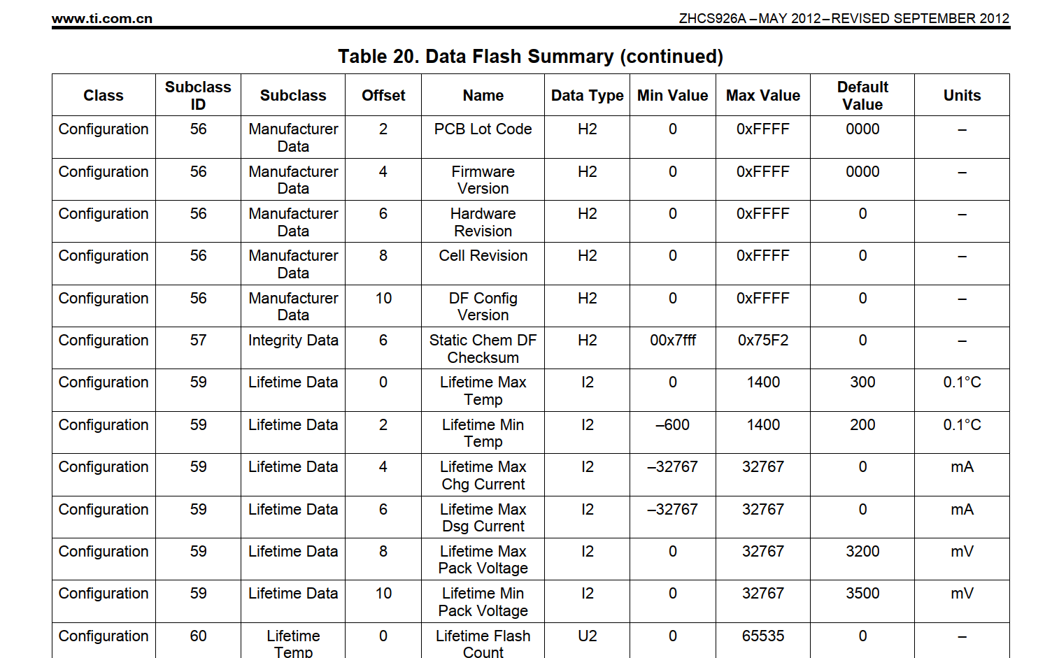

BQ34Z100 Data Flash 的地址是什么?首地址+偏移?有没有相关文件可以参考下?
Genius 3755 points
Other Parts Discussed in Thread: BQ78350, BQ34Z100
我想用单片机做校准参数,发送参数的格式是什么?
BQ78350 格式是这样:
//Frame1:Start + Device Address :0x16 + ManufactoryBlockAccess : 0x44 + Data Length: 0x02 +DataFlash Address:0x00 , 0x40 + Checksum: 0xAB + End
//Frame2:Start + Device Address: 0x16 + ManufactoryBlockAccess :0x44 + Re-Start + Device Address:0x17 + Data Length:0x22(DataFlash Address 2bytes+32bytes data) + 34bytes Data + Checksum:0x85 + End
那么这个BQ34Z100 格式是怎么样?可否提供一点思路?
