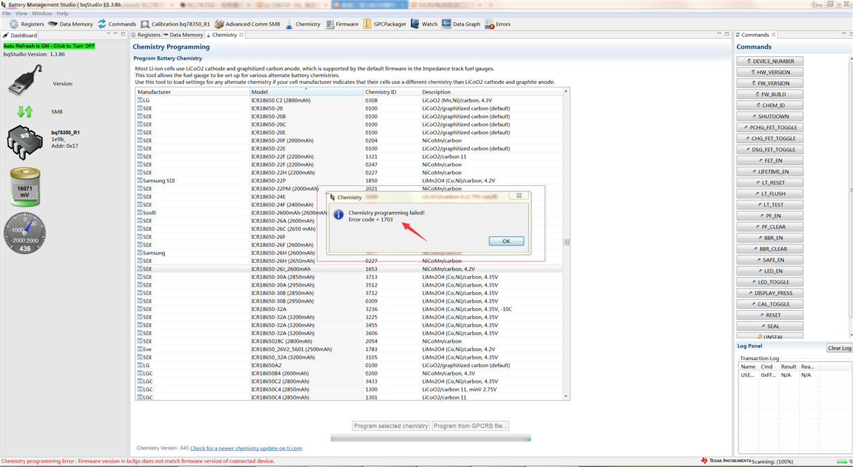

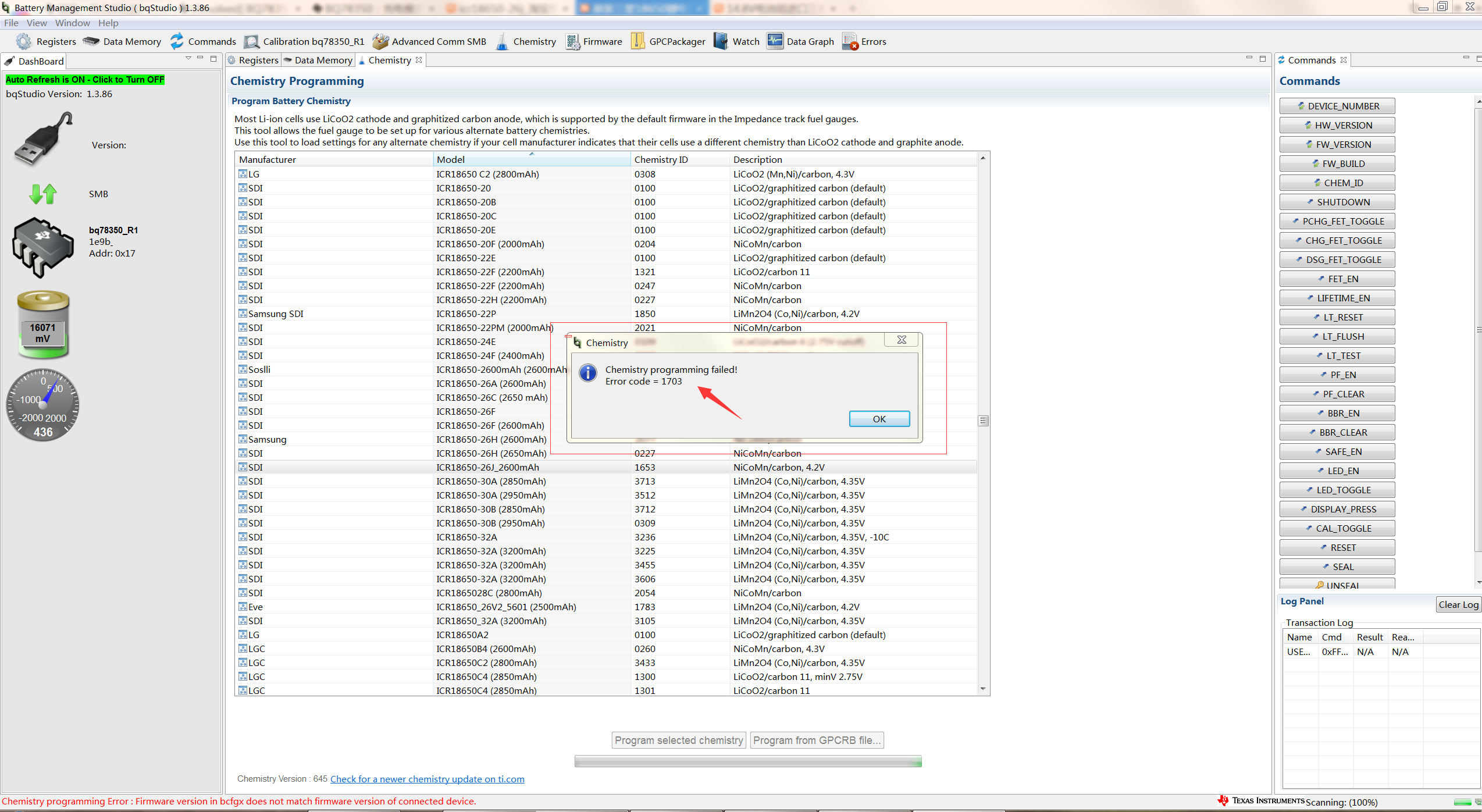

Error 1703 occurs on chemistry programming when the bqz file used does not match the firmware in the part.
