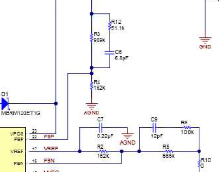

To avoid coupling noise into the control loop from the feedforward capacitors, the feedforward effect can be
bandwith-limited by adding a series resistor.
