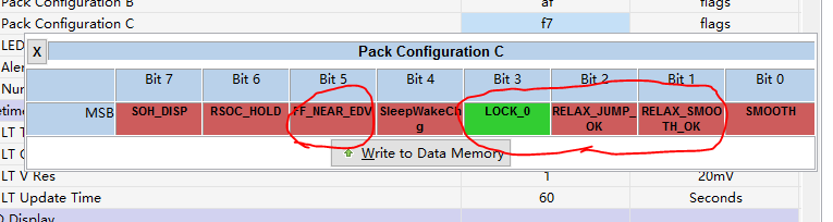

BQ34Z100-G1的Pack Configuration C Register 寄存器,我有几个bit不太理解,手册上解释不是很清楚,如下图圈出来的4个bit,麻烦TI工程师帮忙解释一下:
我用的是LIPO电池组,请问我按照上图的配置可以吗?
  • RELAX_JUMP_OK: Allows RSOC jump during RELAX mode if [SMOOTH =1] 这个bit设置RSOC出现跳变
    RELAX_SMOOTH_OK: Smooth RSOC during RELAX mode if [SMOOTH =1] 这个bit设置RSOC平缓的变化
    LOCK_0: Keep RemainingCapacity() and RelativeStateOfCharge() jumping back during relaxation after 0 is reached during discharge. 这个bit 不建议设置。
    FF_NEAR_EDV: Enables Fast Filter Near EDV 这个bit可以设置,help with IT simulations track capacity as the battery nears 0% RSOC.
