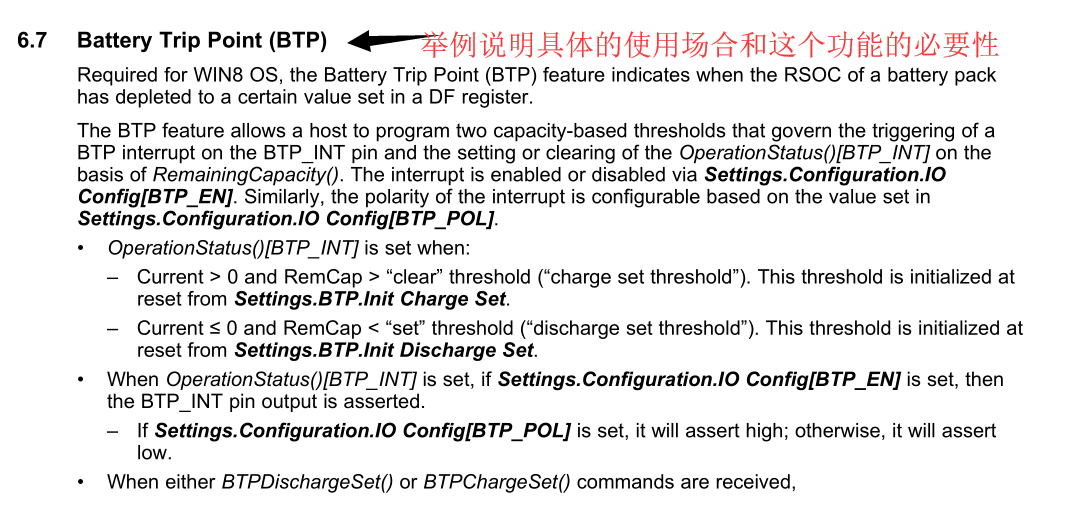

bq4050 BTP功能详解
  • The BTP is merely an indicator to the gauge to set an interrupt when the capacity thresholds are exceeded in one or another direction. You can choose to use it if you want an indication when the battery reaches a particular threshold, set by default to 150mAh for set and 175mAh for clear thresholds. The use of this is to indicate to the host that a significant remaining capacity threshold has been exceeded in either direction.
