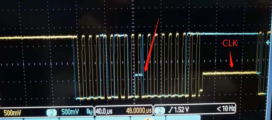

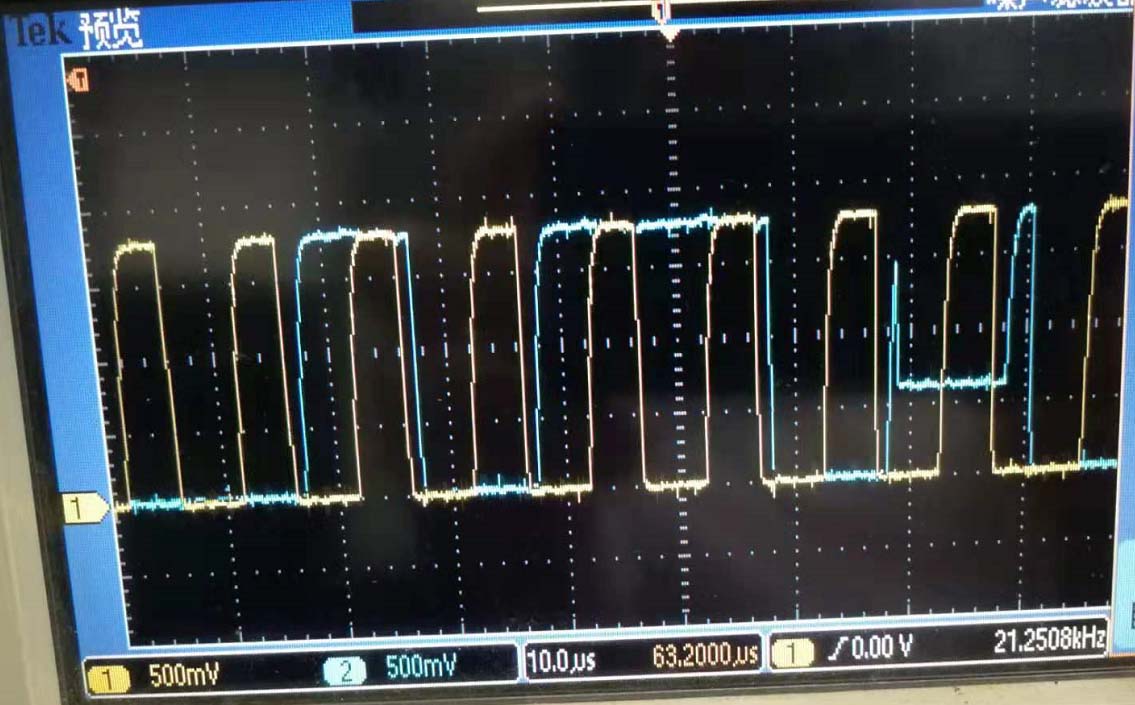

我在应用BQ40Z50时,遇到一些问题:数据电平(第九位)有拉不低现像,时钟有时也不高不低。如下图:望各位大神解答,谢谢!
When I use BQ40Z50, I encounter some problems: data level (No. 9) can not be pulled down, and the clock is sometimes not too high or too low. The following picture: I hope you can answer, thank you!

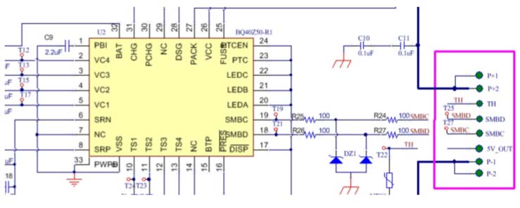

应用电路路如下图:电池输出直接DSP,内部上拉到1.8V
The application circuit is as follows: Battery output direct DSP, internal pull-up to 1.8V
