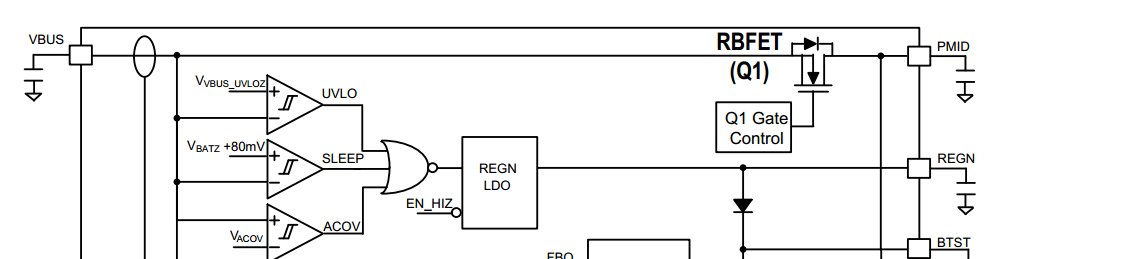

During boost mode, the status register VBUS_STAT bits is set to 111, the VBUS output is 5V by default
(selectable via BOOSTV register bits).手册上说明VBUS输出5V,但是只有PMID输出了5V,是不是手册写错了??????
