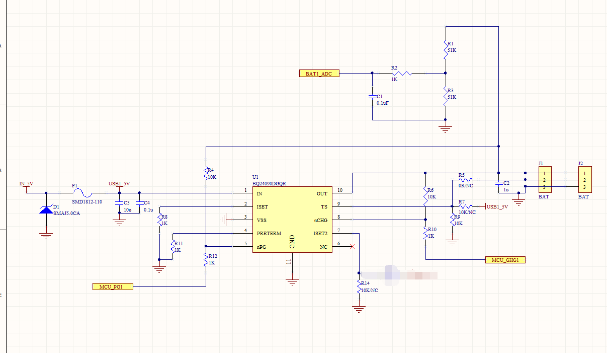

BQ24090充电电流达不到500mA
Other Parts Discussed in Thread: BQ24090
详细阅读BQ24090数据手册后,修改ISET2引脚状态为低电平,启用ISET设置电流。ISET引脚外接1K电阻,但是实测为170mA左右。锂电池电压为3.7V。帮忙看一下原理图是否有什么问题,为什么达不到540mA?谢谢
  • Some Trouble Shooting tip for the device family
    If the device does not start charge, no current to battery check:
    1.TS pin voltage needs to be between 278mV and 790mV for normal operation
    2.Check that input voltage is below OVP, 6.6V.
    3.Double check ISET and PRETERM resistors, low charge current could cause problems.
    Charge will start but current to battery is low of target:
    1.TS pin voltage needs to be in the normal range. At low temp half charge will reduce current TS between 790mV and 1230mV
    2.ISET2 pin, Float will limit current to 100mA
    3.Input voltage low, need 700mV to 1000mV drop across the device for full output current.
    4.Internal thermal limit, if the die temp reaches 125C output current is reduced to control thermal rise.
    The Charge May Terminate Early or at lower voltage:
    1.TS pin voltage needs to be in normal range. At hot temp charge voltage is reduce to 4.06V TS between 278mV and 178mV.
    2.Resistance between the battery and charger will increase voltage at BAT terminal and appear as higher battery voltage.
    Also:
    1.Battery or battery simulator required for test standard load will not work.
    2.CHG and PG pin will give some insight into condition of device.
    3.Check the voltage at ISET, it should be proportional to output current reduced by 400. Iout/400 * R-ISET.
    4.Voltage at ISET represents output current and voltage at PRETERM represents termination point.
    5.Battery voltage for normal charge current needs to be between 2.5V and 4.1V. Below or above and current is reduced.
