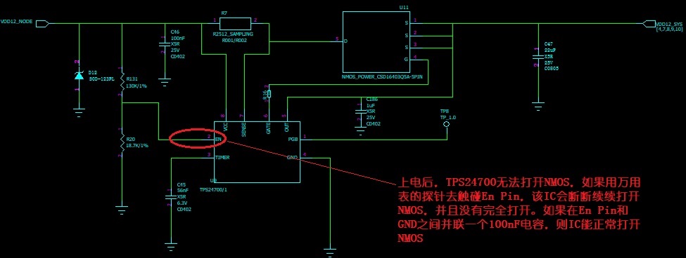

TPS24700热插拔控制器的En Pin异常
Other Parts Discussed in Thread: TPS24700
