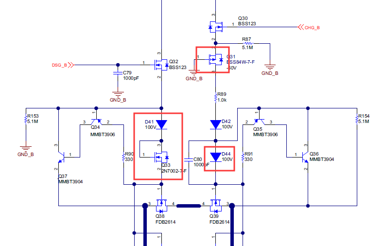

官方开发板中20串原理图,MOS驱动电路有几处疑问
Other Parts Discussed in Thread: TIDA-01093
如下:
1. 放电控制中的 D41和Q33是起什么作用的
2. 充电控制回路中Q31和D44是起什么作用的
  • Q31 allows the charge FET gate to drop below GND_B potential. Without it Q30 would be a voltage follower and the charge FETs would turn on again if the battery voltage was much less than the charger voltage.
    Q33 provides a voltage drop to allow variation of the voltage at the Q32 source without triggering the expedite shutdown circuit (Q34, Q37) mentioned in the TIDA-01093 design guide section 2.1.
  • 免费分享给大家:
    1. 充电器电压一般会比电池电压高2V左右,所以GND_B电压会比C-高2V,如果没有Q31这个MOS管,那么当CHG_B输出低电平的时候,相对于C-仍然是2V高电平,      那么充电MOS还是会打开
    2. Q33是为了防止当DSG_B电压出现波动时,Q34三极管打开
