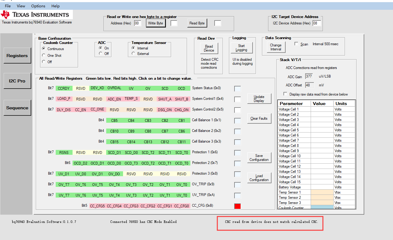

bq769X0 Evaluation Software软件,使用EV2300连接bq76930进行通信,为什么会出现crc校验错误
Other Parts Discussed in Thread: BQ76930, BQ78350
  • with the bq76930, a part which has CRC enabled, the intermittent behavior could only be attributed to a possible bus contention or a USB port issue on the PC/Laptop. Kill all other applications running in the background.
    Check (1) the 6 cell connection are properly connected. i.e minimum 3 cell/group.
    (2) bq76930 and bq78350( if using) should NOT be read at the same time due to bus collisions on the I2C.
    (3) Turn off CB bits and try with a less complicated register setting.
  • 这部分的内容在哪个文档中有具体说明啊    这个是因为冲突引起的吗?   并不是单独关闭了crc功能?
