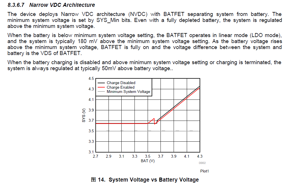

想问题一下关于BQ25606这颗料 NVDC模式的解答  对这段话不是很理解。想请TI的工程师解答一下。
  • 关于NVDC 您参考下面的描述
    To the charger, the charging current and system load are all part of the output power. When the input power is at the set threshold (via IINDPM or VINDPM), it will limit the output power. Normally, this will reduce the charge current if possible. However, in a continued overload case or when the battery is not present, it will allow the system voltage to droop.
