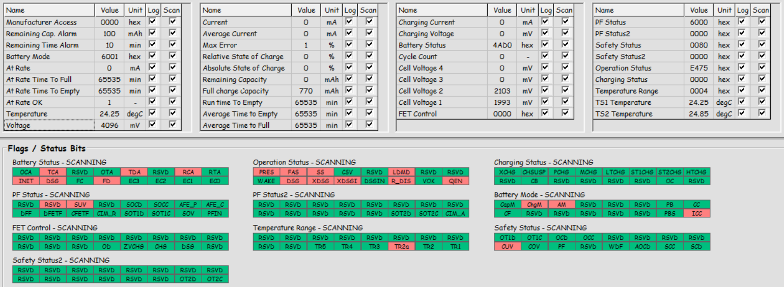

GENERAL PURPOSE OPEN DRAIN DRIVE CIRCUIT (GPOD)
The General Purpose Open Drain output has 1-mA current source drive with a maximum output voltage of 25 V.
The OD output is enabled or disabled by OUTPUT_CONTROL register (bit 4) and has a default state of OFF.
您可以排查一下为什么OD会举起
