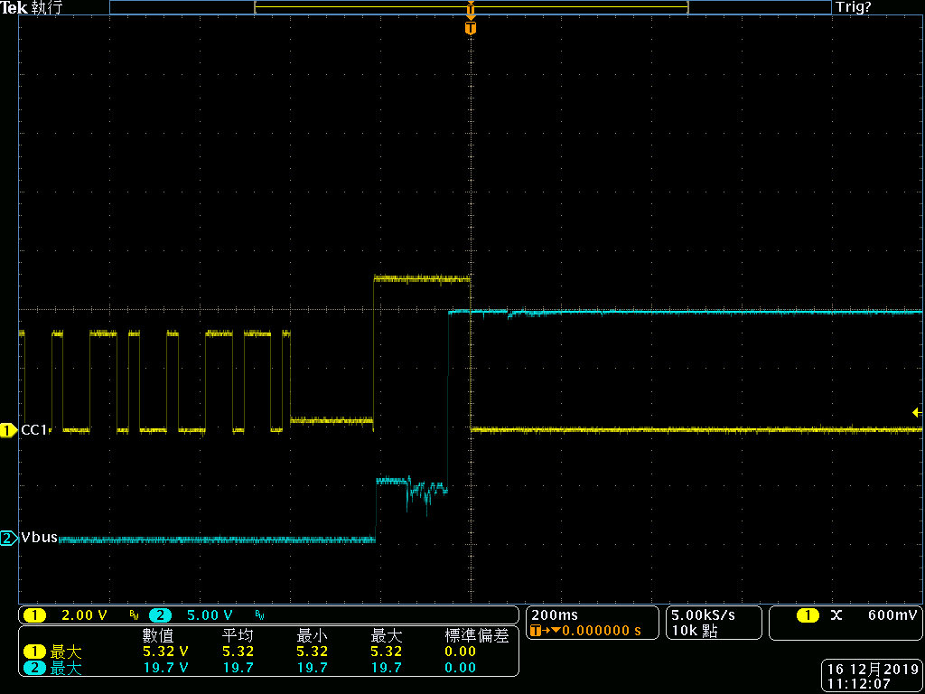

1. Below jpg   ----- The DOCK TPS65988DDJ Power on >> connect to  USB Type C cable to Lenovo T480 NB ----The CC  Handshake and PD  is Good .

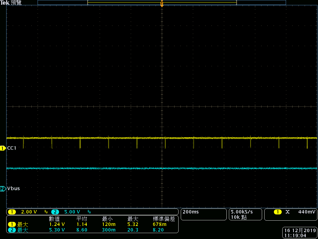

2.  If  USB Type C Cable connect to T480 NB first, then turn on the DOCK Power (TPS65988DDJ power on ) ---- The  CC Keep 1.2x voltage , and handshake file PD Source  voltage is not  success.  below  as  jpe
  Below as question :
 1.  TPS65988DDJ  have  dead battery function ?
 2.  Try the  TPS65988DDH Chip , test is good on the T480 NB not find the same issue, but the FW is different.
    Note : TPS65988DDJ  user tool  6.2.3  version ;  the FW TPS65987_88_F807_12_37  and TPS65987_88_F807_12_50 version both the same on the issue .
     So please help analyze and discuss this issue. How to solve it. Update FW?
