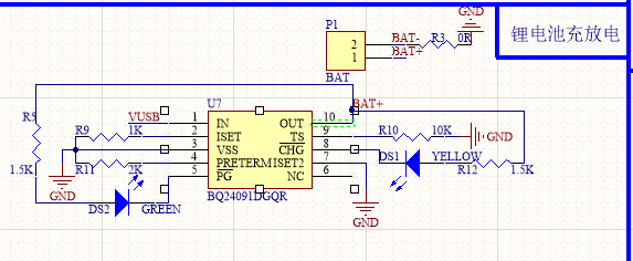

请问我的BQ24091电路对吗?为什么我插上电池CHG引脚就会拉低相应灯就亮了,我还没有给输入引脚供电
bq24090/2/5 -10k at 25°C NTC thermistor & bq24091/3 -100k at 25°C NTC thermistor,
If NTC sensing is not needed, connect this pin to VSS through an external 10 kΩ/100kΩ resistor.
