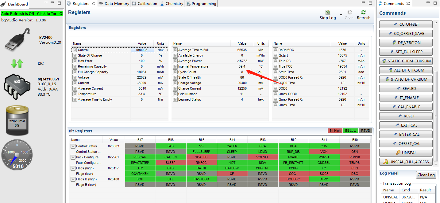

BQ34Z100-G1 再放电或者充电CYCLE COUNT就一直往上升。现在才开始放电就已经到8了。正常情况应该是一个循环才加一吗?
  • 2.2.9 CycleCount(): 0x2C/0x2D
    This read-only command pair returns an unsigned integer value of the number of cycles the battery has
    experienced with a range of 0 to 65535. One cycle occurs when accumulated discharge ≥ CC Threshold.
    您看一下CC threshold 值的设置。
