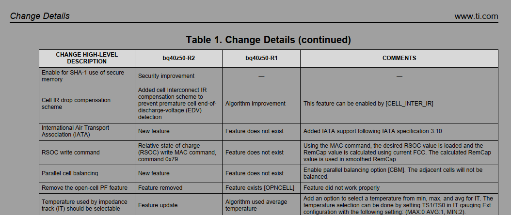

因为change list文档中说BQ40Z50和R1是可以烧录R2的firmware的,
“The existing bq40z50 and bq40z50-R1 integrated circuits and evaluation modules (EVMs) can be
upgraded to bq40z50-R2 FW by downloading the .srec firmware file for v2.08 from TI.com. ”
如下所列的改动,是硬件的变动还是软件变动? 当R1烧录R2的固件,是不是就有了下面表格中R2的功能了呢?
