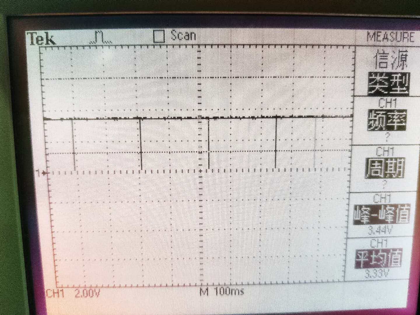

TPS25200芯片过流保护后,fault引脚不再是高电平,一直有脉冲输出
Other Parts Discussed in Thread: TPS25200
我们使用TPS25200来作为USB的电源保护器件,在模拟USB过流保护的之后,拔出USB过流保护的故障源,FAULT引脚没有恢复为高电平,变成了持续的脉冲输出,需要重新断电重启才可恢复
  • USB过流保护器件有过流关断和热关端,可以在过流保护移除后,使得芯片温度降低后再测试看看。
  • Hi
        The TPS25200 thermally protects itself by thermal cycling during an extended overcurrent condition. The device turns off when the junction temperature exceeds 135°C (typical) while in current limit. The device remains off until the junction temperature cools 20°C (typical) and then restarts. The TPS25200 cycles on/off until the overload is removed (see Figure 26 and Figure 29).
        The FAULT signal is not deglitched when the MOSFET is disabled due to an overtemperature condition but is deglitched after the device has cooled and begins to turnon. This unidirectional deglitch prevents FAULT oscillation during an overtemperature event.
