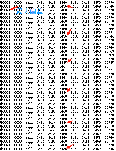

使用BQ76930做6串电池保护板,第三节(芯片CELL5)采样不定时的波动,请问原厂大神这种情况一般是什么原因?
6串电池组,第三节(芯片CELL5)采样不定时的波动,均衡电路是关闭的,其他的CELL采样正常,两块板子都是同样情况,应该可以排出焊接原因,测试了两个电池组都是一样情况,可以排出电池原因,请问这种情况一般是什么原因?

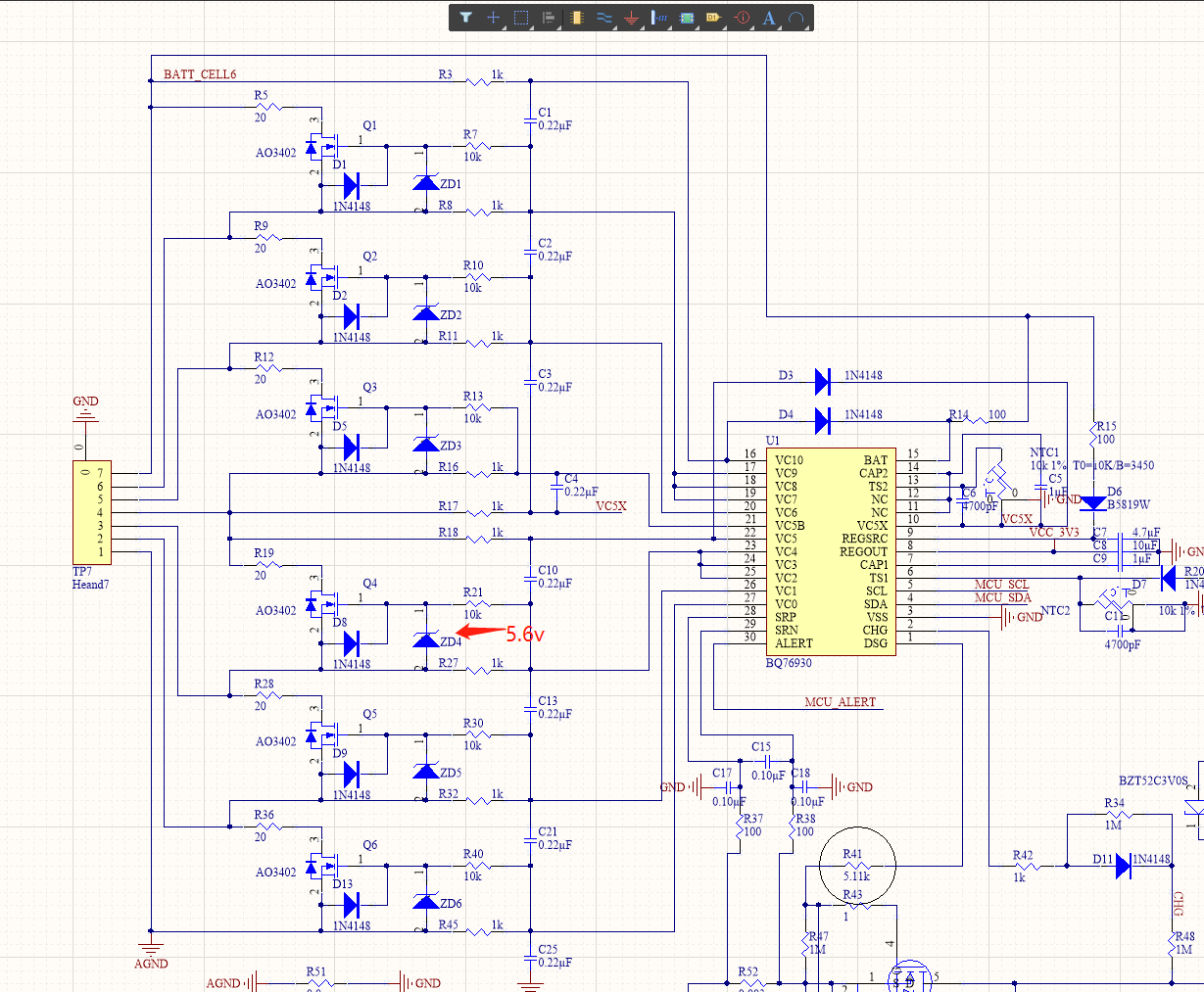

  • 您好,请参考下面的答复:
    The thermistor is energized every 2 seconds during the cell 5 (of the device) measurement for temperature measurement on TS1. Cell 5 of the device is cell 3 in this system. Current for the thermistor comes from VC5X through R17 and the path back to TP7.
    At 25C the current should be about 165 uA causing about a 165 mV drop across R17. If the thermistor is shorted it may draw about 330 uA with 330 mV drop across R17. Neither should normally cause D3 to forward bias and pull down the cell voltage (unexpected current through R18). If D3 has been replaced by a Schottky type it is more common to see this type voltage disruption at high temp when the thermistor is a lower voltage. Of course diodes are not ideal & have a curve.
    Things to check:
    •Be sure D7 is effective and not loading TS1
    •D3 type
    •R17 value
    •R17 connection integrity
    •Trace resistance to cell connector
    •Contact resistance of the connector or other interconnect resistance.
    1k is the recommended value for Rf, it avoids discharging VC5X during short circuit event timing. If suitable Rf (R17) can be made smaller to reduce the voltage drop during the temperature sample such as they have done with R14. Be sure VC5X stays above VSHUT during SCD events.
  • 谢谢,确实是R17的问题和D3的问题,R17改成100R或者D3由肖特基二极管改成普通二极管都不会出现异常了
