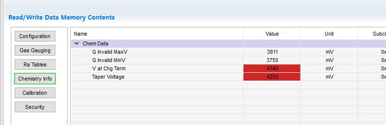

bq27426 导入gg.csv文件问题?
设置了 Dsg Current Threshold = 5000/16.7 = 299
Chg Current Threshold = 5000*10/128= 390
Quit Current = 5000  /25 = 250
Design Capacity = 5000
Design Energy = 5000*3.8
Terminate Voltage = 3330mV
Taper Rate = 5000*10/150 = 333
Taper Voltage =  4200mv
V at Chg Term = 4350mV
设置之后保存为 gg.csv文件,往data memory写入 write all之后,发现错误如下:
1.请问如何解决?
2.如果不write all,影响不影响电池曲线学习?
