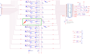

参考官方BQ76940的电路自己做了块15串的板子,为了调试方便,在各路均衡都加了指示灯。
现在的问题是接入电池采集线,BQ76940还没有启动,板子上的第6串均衡就开启了,指示灯也亮了。
启动BQ76940后依然是这种状态,ALERT管脚始终3.3V,读SYS_STAT寄存器,DEVICE_XREADY,SCD,OCD位都是1,
无法改写。请问这是什么问题?

您好,请参考下面的内容
You have an XREADY condition. One of the groups has lost power or there is a voltage trapped on the TSx pins preventing proper start up. See other posts or the FAQ.
Check power at the BAT and VC10X pins.
Check for voltage across CAP2 and CAP3 capacitors
Check the connection of the thermistors, they must have a resistance and be connected to the appropriate reference.
