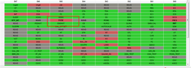

BQ40Z50-R1: FUSE_EN已经关闭,放电时FUSE保护标志位还是会亮起,同时停止放电了,这是什么原因呢?希望得到TI工程师的解答,谢谢!
Part Number: BQ40Z50-R1
  • 您好,下面FUSE disable以后是否reset,请参考TRM13.1.22ManufacturerAccess()0x0026Fuse
    In UNSEALED mode, the ManufacturingStatus()[FUSE_EN]status is copied to Mfg Status Init[FUSE_EN] when the command is received by the gauge.The device remains on its latest Fuse Control setting prior to a reset
