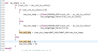

TIDA-00961: Regarding the issue that ton should be expanded when toff is expanded, that is, add ton_adj_dbg to ton_calc
Part Number: TIDA-00961

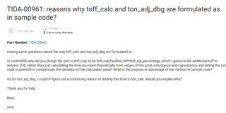

Someone asked such a question on the forum before: ,andThe engineer’s answer at the time was like this : ,According to what he said, in (vout_vin < ac_vol_in_volts),we need expend ton. But The code is like this in (vout_vin < ac_vol_in_volts), ton_adj_dbg=0,this seems to contradict the engineer’s answer .I don't why , hope your reply.
