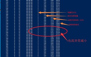

  • 充电才3%,应该没有进CV模式吧
  •       log 数据如附件
    Start: PwrTest

    Elapsed(s)  Battery  AC/DC  Remaining Time  Cap(%)  Cap(mWh)  Rate(mW)   mVolt
             0        0     AC        00:00:00       0        53      3065   10378
             5        0     AC        00:00:00       0        57      3037   10396
            10        0     AC        00:00:00       0        62      3029   10413
            15        0     AC        00:00:00       1        66      3032   10431
            20        0     AC        00:00:00       1        70      3035   10446
            25        0     AC        00:00:00       1        74      3070   10467
            30        0     AC        00:00:00       1        79      3047   10480
            35        0     AC        00:00:00       1        84      3069   10500
            40        0     AC        00:00:00       1        88      3057   10513
            45        0     AC        00:00:00       1        92      3061   10529
            50        0     AC        00:00:00       1        96      3063   10541
            55        0     AC        00:00:00       1       100      3065   10555
            60        0     AC        00:00:00       1       104      3070   10570
            65        0     AC        00:00:00       1       108      3072   10583
            70        0     AC        00:00:00       1       113      3075   10597
            75        0     AC        00:00:00       1       117      3080   10611
            80        0     AC        00:00:00       1       122      3091   10626
            85        0     AC        00:00:00       1       126      3085   10638
            90        0     AC        00:00:00       2       131      3088   10652
            95        0     AC        00:00:00       2       135      3100   10664
           100        0     AC        00:00:00       2       139      3096   10677
           105        0     AC        00:00:00       2       143      3109   10687
           110        0     AC        00:00:00       2       147      3111   10701
           115        0     AC        00:00:00       2       151      3113   10711
           120        0     AC        00:00:00       2       156      3116   10724
           125        0     AC        00:00:00       2       161      3120   10737
           130        0     AC        00:00:00       2       165      3123   10748
           135        0     AC        00:00:00       2       170      3124   10760
           140        0     AC        00:00:00       2       174      3126   10771
           145        0     AC        00:00:00       2       178      3129   10781
           150        0     AC        00:00:00       2       183      3131   10792
           155        0     AC        00:00:00       2       187      3136   10803
           160        0     AC        00:00:00       2       190      3133   10811
           165        0     AC        00:00:00       3       195      3135   10819
           170        0     AC        00:00:00       3       200      3138   10833
           175        0     AC        00:00:00       3       204      3139   10841
           180        0     AC        00:00:00       3       209      3141   10761
           185        0     AC        00:00:00       3       212      2090   10753
           190        0     AC        00:00:00       3       215      2084   10753
           195        0     AC        00:00:00       3       218      2092   10756
           200        0     AC        00:00:00       3       220      2081   10758
           205        0     AC        00:00:00       3       223      2092   10763
           210        0     AC        00:00:00       3       226      2072   10764
           215        0     AC        00:00:00       3       229      2056   10765
           220        0     AC        00:00:00       3       232      2054   10765
           225        0     AC        00:00:00       3       235      2027   10758
           230        0     AC        00:00:00       3       238      2038   10769
           235        0     AC        00:00:00       3       240      2025   10768
           240        0     AC        00:00:00       3       243      1984   10777
           245        0     AC        00:00:00       3       246      1951   10775
           250        0     AC        00:00:00       3       248      1907   10777
           255        0     AC        00:00:00       3       251      1882   10777
           260        0     AC        00:00:00       3       254      1802   10776
           265        0     AC        00:00:00       4       257      1786   10770
           270        0     AC        00:00:00       4       259      1778   10774
           275        0     AC        00:00:00       4       261      1646   10768
           280        0     AC        00:00:00       4       263      1719   10774
           285        0     AC        00:00:00       4       266      1652   10774
           290        0     AC        00:00:00       4       268      1672   10771
           295        0     AC        00:00:00       4       270      1652   10771
           300        0     AC        00:00:00       4       273      1623   10773
           305        0     AC        00:00:00       4       275      1618   10773
           310        0     AC        00:00:00       4       277      1608   10773
           315        0     AC        00:00:00       4       280      1601   10775
           320        0     AC        00:00:00       4       282      1600   10776
           325        0     AC        00:00:00       4       284      1595   10777
           330        0     AC        00:00:00       4       286      1592   10778
           335        0     AC        00:00:00       4       288      1589   10779
           340        0     AC        00:00:00       4       290      1587   10781

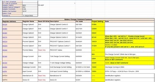

    BQ24780S的寄存器赋值如下,看看有没有设置不合适的?
  • 您好,请将电流下降前后的参数发过来看一下。电流下降时VIN 的电压和SYS负载是多少。
  •       1、VIN=20V;
              2、在WINDOWS系统下,没有跑任何重载程式,处于空载状态
