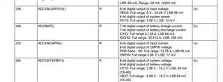

您好,请参考数据手册Table 9-9. Charger Command Summary,具体哪个寄存器不更新。
您好,请参考数据手册9.6.16 ADCOption Register (SMBus address = 35h) [reset = 2000h],将对应的位使能。
i do it but no use ;最开始就配置好了
uint8_t Bq25720RegData[16][3]=
{//reg ,lowData,highData
{0x12,0x1c,0x87},
{0x14,0x40,0x06},
{0x15,0xF0,0x04},
{0x3B,0xFC,0x00},
{0x3C,0x00,0x0A},
{0x3D,0x00,0x00},
{0x3E,0x00,0x7A},
{0x3F,0x00,0x20},
{0x22,0x00,0x00},
{0x30,0x00,0x33},
{0x31,0xB7,0x00},
{0x32,0x34,0x04},
{0x33,0x09,0x4A},
{0x34,0xA0,0x41},
{0x35,0x43,0xC0},
{0x37,0x48,0x00},
您好,请参考下面链接,确认ADC设置成功。
https://e2e.ti.com/support/power-management-group/power-management/f/power-management-forum/885035/bq25703a-i2c-readback-registers-not-functioning/3273022?tisearch=e2e-sitesearch&keymatch=BQ25720%2520ADCOption%2520Register#3273022
