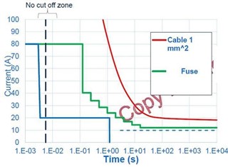

Hi
Can LM5060 achieve the green IT curve as below?  I know '
The LM5060 is designed to drive an external high-side N-channel MOSFET. Over-Current protection is
implemented by sensing the voltage drop across the MOSFET. When an adjustable voltage drop threshold is
exceeded, and an adjustable time period has elapsed, the MOSFET is disabled..'
But I am not sure if our IT curve could be so many steps or similar. Thanks.
