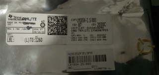

请查收一下附件的检测报告 支持一下如果换货吧。
不知道为什们不支持 发英文版的 E2E
我们想换一批货 谢谢

为便于调查,当时E2E需要您提供以下信息:
1. photo of the reel label
2. X-ray photos showing the issue mentioned. (已提供)
Can you please also explain what the acronym PDA means? (that is, what does it mean when you say PDA is <=15% or PDA is 37%, what is the expected value)
请问是否能提供标签照片?另外原始帖子中提及的PDA是什么的缩写,后者说PDA is <=15% or PDA is 37%是什么意思?
请问您原始帖子中提及的PDA是什么的缩写,后者说PDA is <=15% or PDA is 37%是什么意思?
The specification requires that the PDA is less than or equal to 15%, and the actual PDA is 37%. The PDA has exceeded the standard and the batch is unqualified

Being the customer likely did not do fine and gross leak test prior to X-section, it will be difficult to say if it is a valid crack or an artifact of the X-section.
We have no history of a glass crack on this device therefore we are unable to accept an RMR request.
