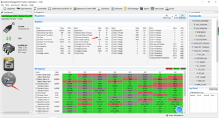

今天在测试容量学习时,电池是三串一并,电芯是松下的3400容量,用0.2C进行充电,充满后,显示3250MAH,在电脑的显示界面按RESER键,容量会变成700MAH。请问是什么原因引起?如何能恢复正常容量?如上图,容量显示为为0,但还一直在放电。
您好,At reset or boot the capacity is estimated using the chemistry data loaded the gauge and the cell voltage. The gauge will attempt to underestimate the state of charge so the system does not expect more capacity than is available. The error is set to 100% so that the system knows it is an estimate.
恢复剩余容量建议充电一段时间。
