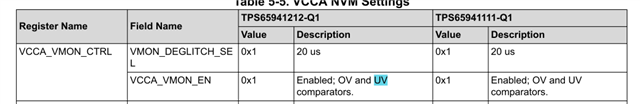

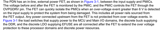

I see the decription that the VCCA of TPS65941 has the OV & UV mechanism for functional safety, but I can't see the detail description of UV mechanism, how does it to slove the under-voltage of the input voltage of VCCA pin? could you give me an explanition for it? or will you tell me which document we can find the detail decription?
like the OV description:
Where can I see the UV description?
