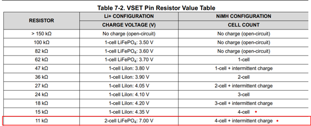

BQ25171-Q1: For the application of BQ25171 Ni-MH battery
Part Number: BQ25171-Q1
For the application of BQ25171 Ni-MH battery, if the circuit is set according to intermittent charging (the red box in the table below), the charging process is that after power-on, if it is judged that it can be charged, it will be charged with constant current, and after the time of constant current charging is up, the battery will be tested by voltage, to determine whether it is intermittently charged, or if it is determined that it can be charged after power-on, it will always be performed according to intermittent charging?
