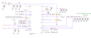

Application: ADAS Power module
1. The circuit is as below:
UGBATT=12V,
SOM_3V3_Enable=3.3V

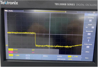

2.Abnormal phenomenon des as below:
while the load is empty, the bulk output votlage is 3.3V (normal), while the load is above 10mA, the ouptut votlage is shut down , then remove the load , the output votlage is rise up to 3.3V slowly about 10s.
We test the case as below:
1OSC connect to Ground and connect to 5V
2Current sense is enable and disable5mR current sense resistor short CS and VOUT unused
3VCCX connect to Ground and connect to Vout
the result phenomenon is the same.

3. The Vout output waveform:

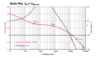

4. The bode plot

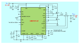

5. The simulation circuit
