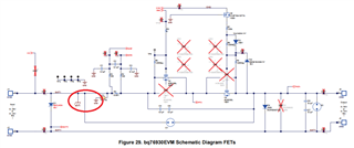

我测定VC1的电压与电池第一节电压相差了0.2V,是不是GND和BAT-没有直接连接造成的?
可以不经过NTC直接短接吗?

您好,GND 和BAT-接的不是NTC是NET-Tie
The Net-Tie shown on page 18 of the bq78350 provides a single connection between the high current path and the low current reference points so that the references are not separated by a voltage drop in the high current path. It is one technique, others may work also.
