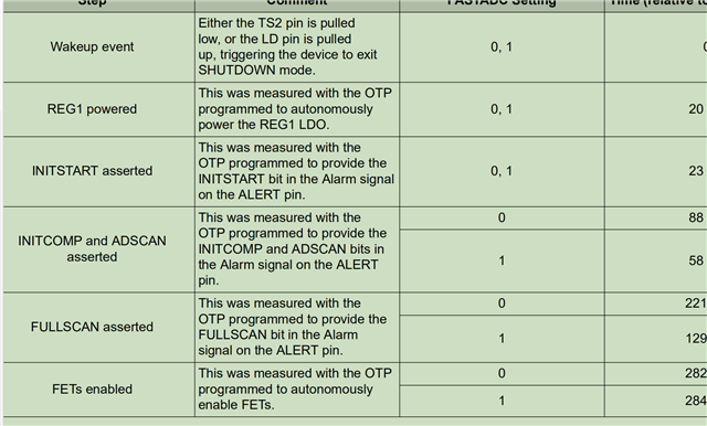

  • 关于第一个问题我还有一个疑问,您的理解跟我实际的需求有些偏差,我是希望通过AFE去唤醒MCU,请问AFE的wake是否可以将其ALERT引脚拉高或者拉低
  • 您好,请参考数据手册16.4 Startup Timing
  • 16.4的表格中并没有提WAKE UP event n能否让ALERT脚拉高,我是希望解决wakeup唤醒,ALERT引脚可以被拉高
  • 您好,wakeup唤醒以后拉高ALERT引脚,说明AFE发生错误。
    The BQ76952 device includes functionality to generate an alarm signal at the ALERT pin, which can be used as an interrupt to a host processor. When used for the alarm function, the pin can be programmed to drive the signal as an active-low or hi-Z signal, an active-high or low signal, or an active-low or high signal (that is, inverted polarity). The alarm function within the BQ76952 device includes a programmable mask, to allow the customer to decide which of many flags or events can trigger an alarm.
    详细请参考数据手册12.8 ALERT Pin Operation

  • 配置ALERT PIN 为拉低的,该引脚有一个上拉电阻到3.3V,正常状态下是为拉高的,请问是否是因为FULLSCAN造成的ALERT脚被拉低
  • 您好,full scan不会造成ALERT引脚异常,您看一下有没有其他异常旗标举起。
