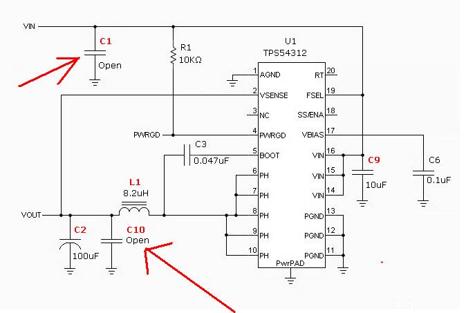

如果要选用,可以参照datasheet,输入选择220-µF POSCAP电容(The input to the circuit is a nominal 5 VDC, applied at J1.
The optional input filter (C2) is a 220-µF POSCAP capacitor, with a maximum allowable ripple current of 3 A).
输出电容选择1nF.
