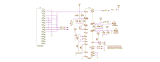

想请问,在没有充电的状况下,8.4v锂电池,最大输出5A,请问sys的最大输出电流是多少?持续电流是多少?电压是多少?现在快充充电器可以输出几种不同的电压以及电流,请问如何确保输入电压在芯片的要求范围内而不会是过压输入?谢谢

您好,请参考When the battery charging is disabled and VBAT is above minimum system voltage setting or charging is terminated, the system is always regulated at typically 50mV above battery voltage.
请参考数据手册表 4. Input Current Optimizer Automatic Operation
10 Power Supply Recommendations
In order to provide an output voltage on SYS, the device requires a power supply between 3.9-V and 6.2-V input with at least 500-mA current rating connected to VBUS or a 2-cell Li-Ion battery with voltage > VBAT_UVLO connected to BAT. The source current rating needs to be at least 3-A in order for the boost converter of the charger to provide maximum output power to SYS.
